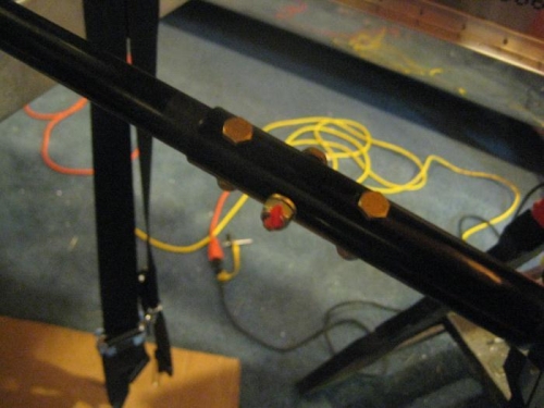

- Finished drilling the 3 holes for the connecting bolts in the elevator pushrod splice (photo #2), then installed the bolts.
- Riveted in the 2 vertical pushrod supports (photo #1).

Pushrod splice completed with bolts installed.
