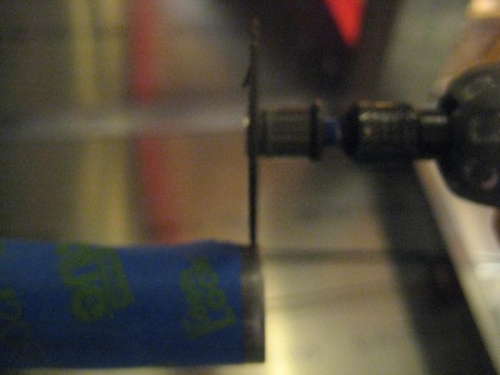

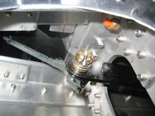

- When I went to the back and checked the elevator horn I found it was not touching the horn stop (red line in photo #1) as it should.
- So I used my Dremel cut-off wheel to cut off a little more than 1/8" of the opposite end of the pushrod. The horn still did not touch so I used my files and a lot of elbow grease to take off enough material so that the horn bottomed out finally.

Elevator horn stop was not making contact (red line)
So I cut down the end of the pushrod

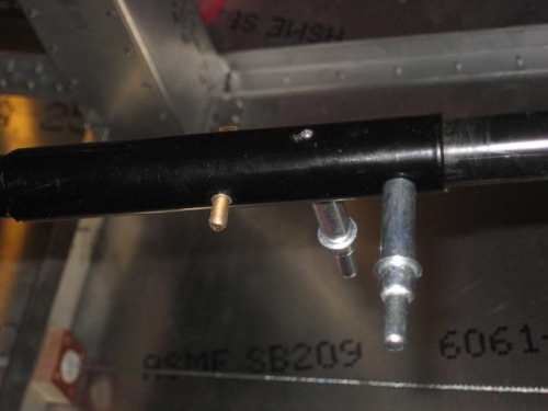

And then began drilling the attachment holes
