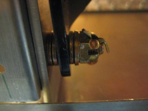

- Sonex's callouts for bronze bushings are too short 90% of the time, even with the paint removed. So I do what I always do; I buy longer bushings at the hardware store and cut them down to size. Photo #1 shows 2 cut bushings. The red lines are roughly where I need to get to, so I use my Dremel cutoff wheel to make the first cuts, then use a file and my Scotchbrite wheel to finish up.

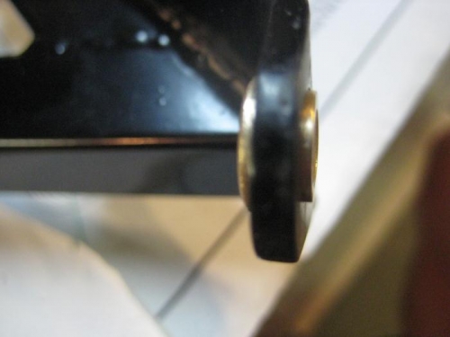

- Photo #2 shows the bushing in place in the control triangle.

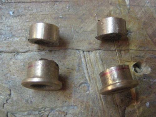

- Photo #3 shows the bolt installed, with extra washers to take up the left/right slop.

Bushings being cut down.
Resized bushing in place.
Control triangle installed with bolt, washers, castle nut and cotter pin.
