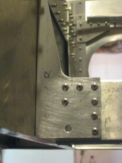

- Re-riveted the two vertical angles on the spar tunnel, this time with the heads on the correct side.

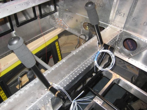

- Test fit the control assembly. There was 3/8" of slack to take up left to right, but 2 washers on one side and 3 on the other got it tightened up.

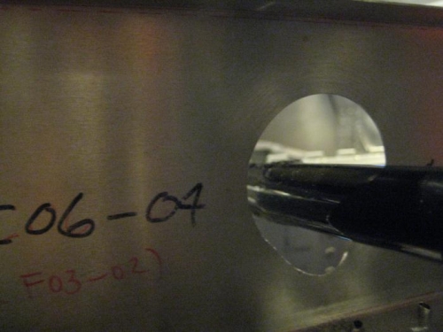

- While testing the travel of the assembly all the way back to the tail, I saw the pushrod was hitting the bottom of the hole in C06-04 (that's F03-02 if you don't do the lowered seat mod). So per photo #3 I enlarged the hole downward with a file to the pushrod travels fully.

I re-riveted these two angles with the heads on the inside.
Test fitting the control assembly.
Enlarged the hole in C06-04 to allow the pushrod to travel fully
