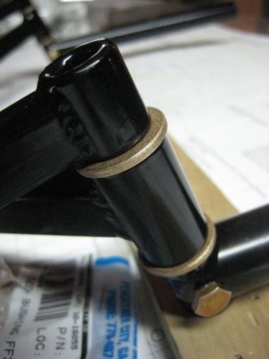

Finished sheet C05 tonight.

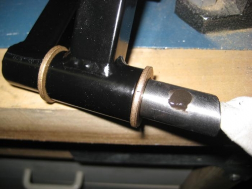

- Finished the second control horn assembly. On the passenger-side stick there was a little slop in the bolt hole. I decided to add some JB Weld to the hole and I'll drill it out tomorrow. That should tighten it up.
- Not pictured: Installed the link rod that ties the two sticks together.
- Installed another of the fuel tank fittings. Went to install the final one for the (optional version) vent line, but the hardware called out on the Sonex plans is way too big to fit the threads that came in the fuel tank. Back to A/C Spruce to try to get the right one.
All the parts installed except the link to link the two sticks together
Closeup of controls in bronze bushings
Some JB Weld to tighten up a hole
