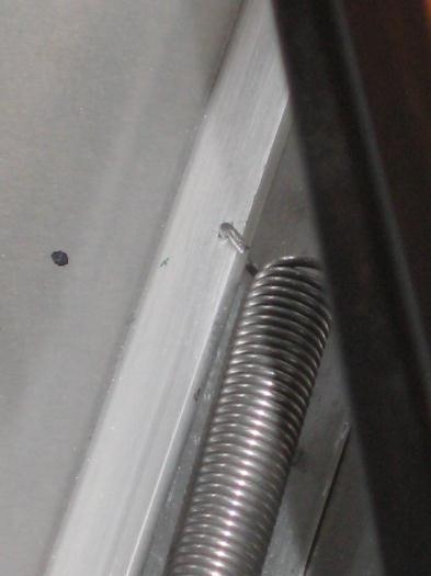

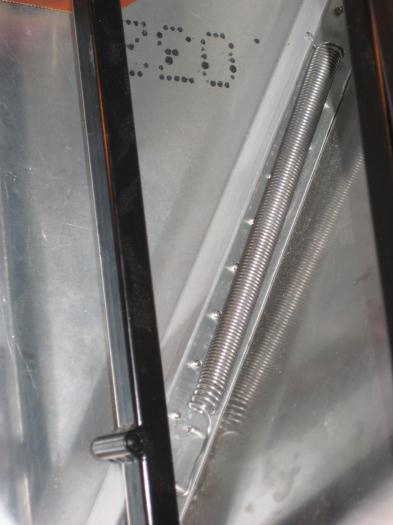

- Max (Waiex builder) sent me photos of his F14-02 details that showed the location of a hole for the rudder return springs. The hole was not shown on my drawing.
- Fortunately I was able to get a drill bit in there to drill the 1/8" dia hole
- Installed the 1 rudder return spring I have (just ordered the 2nd)

Rudder return spring in background, against diagonal longeron
Hole drilled in diagonal longeron for spring
