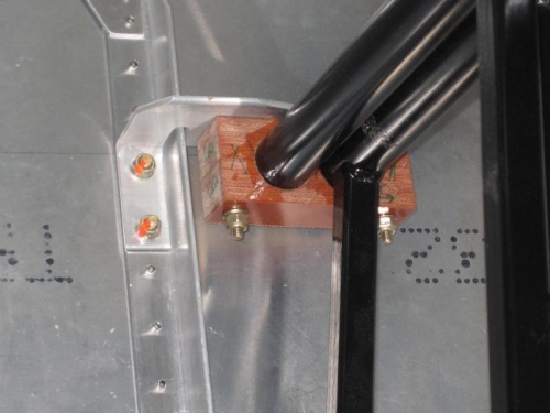

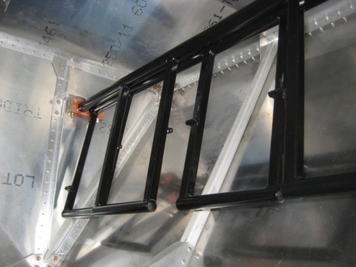

- I was advised to install the rudder pedals BEFORE the gas tank, so that's what I worked on tonight.
- Test fit them in place but they were binding quite a bit. I think it's because the blocks may not be perfectly parallel to one another.
- So removed everything and shaved something out of each hole. Reinstalled and was certainly better, but the rear rudder pedals were still binding, so tomorrow I'll remove some more material and hopefully that will do it.
In place for a test fit
Close up of support block
