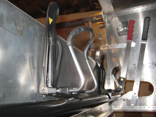

- Reinstalled the water bottle cages above the flap tube (before I realized the flap tube went there I installed the water bottle cages too low). They are riveted in place with flush rivets in the dimpled front face of the spar tunnel.

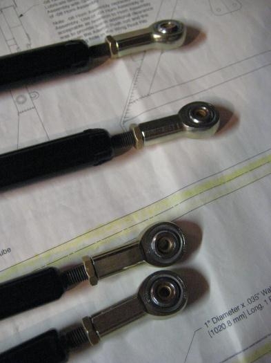

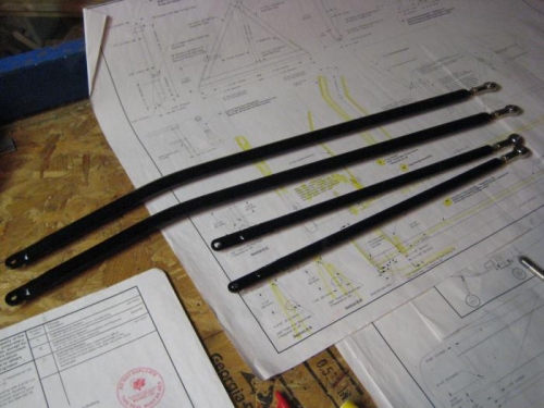

- Per C03, installed the rod end bearings at the ends of the flap and aileron push rods. The rod end bearings all got bronze bushings in them to make the i.d. of the bearing smaller. This was per the alternate hardware on the C03 drawing, and as provided by Aircraft Spruce.

Water bottles reinstalled above flap tube
Flap & aileron rods w/ rod-end bearings & check nuts
Close up
Close up
