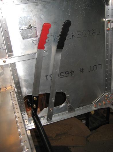

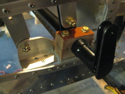

Install flap/brake controls
- Removed the flap handle and flap detent bracket
- Enlarged the forward and aft flap detents (per my last log post) and reinstalled the bracket
- Made a bend of several degrees in the flap handle so it now sits nicely in the detents
- Installed the brake handle/bracket assembly as well
*** HIT 1,500 HOURS ON THE PROJECT TONIGHT ***
Flap and brake handles installed
Flap/brake assembly view from exterior
