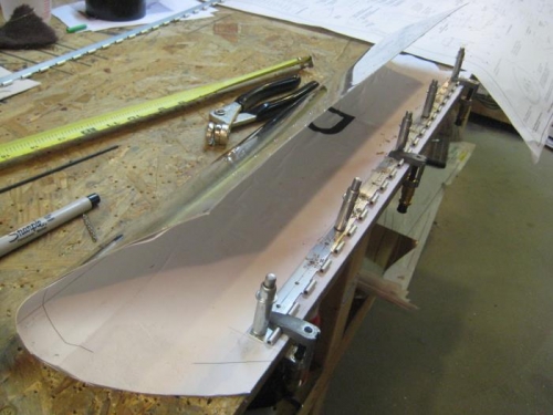

Kept going on the gear leg fairings.
- Cut the 4 hinge halves to length, marked them, and pilot drilled them.
- Clamped the hinges in place per the photo below.
- Pilot drilled through the hinge holes, through the fairing skin
- Updrilled and then deburred everything
I also put a little more filler around the nose of the lower cowling. Next I need to shape and sand it, then glass over it.
Drilling through the hinges into the fairing.
