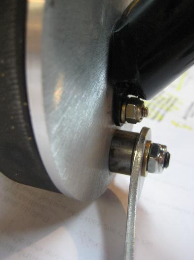

- I was having trouble getting the axle square with the brake back plate. The little tab at the bottom of the axle tube had to be bent down a little, and a thin washer added, to get it to true out. This took a LOT of trial and error, but I finally got it as true as it's ever going to get.

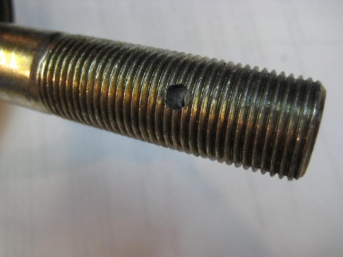

- Then I put the wheel, bearings, and axle together, and spun on the huge castle nut to hold the wheel in place. Then I marked the axle the the cotter pin hole, and drilled it on the drill press (see photo #3).

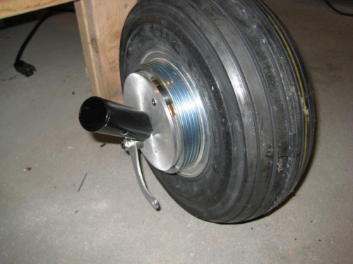

- I started on the right wheel/axle assembly. I think I got the axle trued to the back plate, but something is not turning true. The brake pads rub pretty heavily in one location. I'll have to figure it out tomorrow.

Axle secured to brake back plate.
This is the right wheel; just starting work on this.
Axle drilled for cotter pin & castle nut
