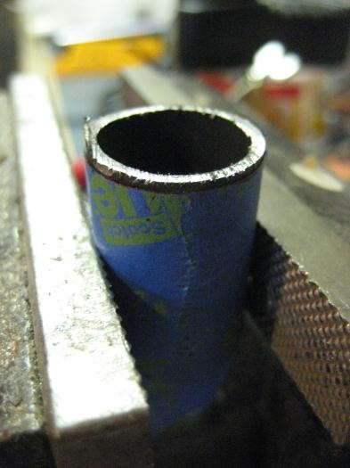

Made the (2) L01-07 wheel axle spacers, and drilled out the ends of the brake cable guides.
Photo #1 shows the first spacer cut. The tape is where the spacer needs to get pared down to. To keep a square end, I measured the 1-5/16" length and marked it in 5 places around the spacer. Then I used some painter's tape to "connect the dots" around the spacer, giving me a square line to cut and file to (see tape in photo #1).
Used a hack saw to get close to the tape line.
A little filing after photo #1 got me a nice finished edge at the tape line. Then I used the Scotch Brite wheel to smooth it out, and finally some sandpaper to smooth the inside edges of the two ends.

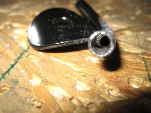

Then I drilled out 2 of the 4 ends of the tubes that make up the brake cable guides (photos #2 and #3).
Then I cleaned up everything with mineral spirits, let them dry, and sprayed them with primer to corrosion protection.
Axle spacer rough cut to above tape line.

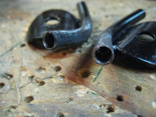

View down the end of one cable guide, with the enlarged hole drilled.
Both guides with their ends drilled out.
