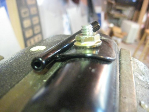

- Drilled a 3/32" pilot hole in the axle assembly, for use later when drilling through it, and the titanium gear legs.

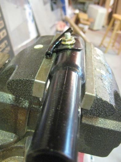

- Used a sacrificial section of steel pipe (photos #1 & #2) given to me by Max Emmighausen, to bolt on the cable guides (which come flat) and use a rubber mallet to bend them around the pipe, to get the correct 5/8" radius. The result is photos #1 & #2.
- In the bending process some of the paint cracked and flaked off, so I sanded off the loose stuff, cleaned the surfaces, and prime painted those areas.

Bending the cable guide washer
A closer view
A closer view
