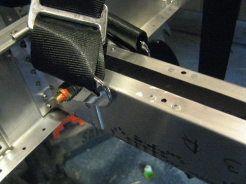

- Got some hardware from A/C Spruce today, so finished installing the center seat belts. The reason I needed a -27 bolt (instead of the -13 called on the plans) is because of the LOWERED SEAT MOD that I'm building. This area is wider in the lower seat version.

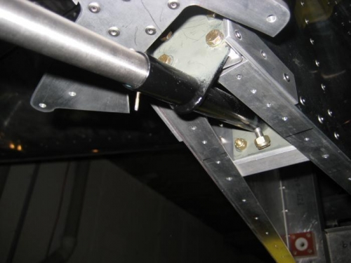

- Watched the EAA video (by Kerry Fores at Sonex) on how to drill the titanium rod for the tail wheel landing gear spring. VERY helpful. Drilled through with a 1/8" cobalt bit, then the final hole with a 1/4" cobalt bit.
- Loosely installed the titanium gear spring with its bolt. The plans say to torque it down, but since I still have to drill another hole in the titanium rod, that can't be done yet.

Attached center seat belts with -27 bolt
Titanium tailwheel spring gear in its fitting (bolt/nut loosely fit)

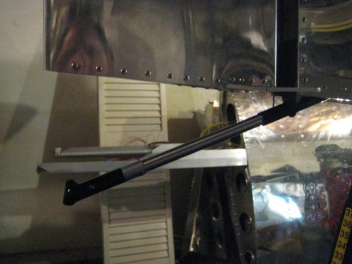

Tail wheel parts from the side. Tape on titanium bar is to set distance for pivot mount
