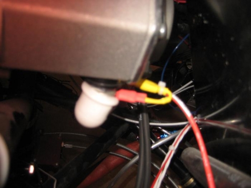

I received the Ztron switch/breaker unit, repaired. I was also sent a diode to install between the starter (+) wire and the starter switch wire. Apparently there was current coming back through the switch wire and that was what was frying and tripping the switch last time.

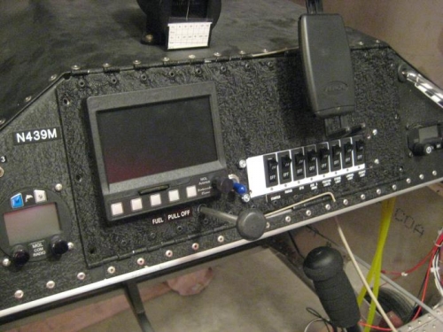

The Ztron switches are solid state and are programable. So I programmed all the switches and then tested the switches that have loads.
Switches reinstalled
Add shunt at starter
