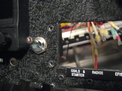

The Ztron switch/breaker setup that I have, has 8 switches. I needed 9 if I was going to separate all my electrics. So I ganged the COIL lead with the STARTER lead. But I really wanted to have the coils on their own switch.

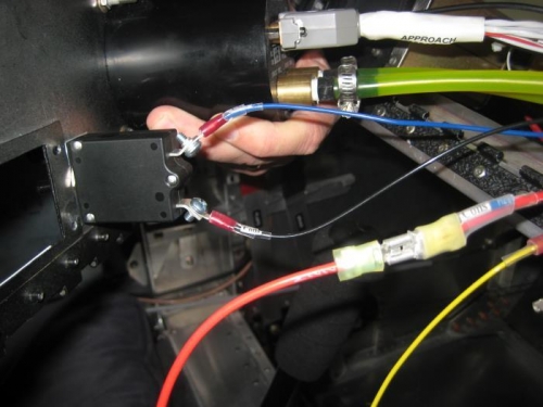

So I ordered a Tyco W31 (5 amp) switch/breaker and installed that in the only small real estate I had on the panel, between the Ztron switches and the EFIS display.
So I separated the starter and coil wires from each other, and installed new crimp connectors, then made a new ground wire for the new switch. I'll need a new label for it.
Back side of new Tyco switch/breaker.
New switch/breaker installed. Note
New switch/breaker installed. Note "5" for 5 amps on the face.
