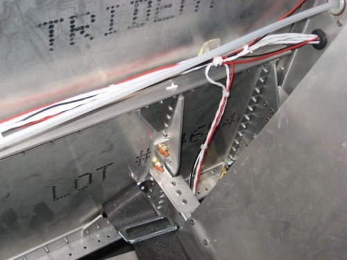

Magnetometer
Magnetometer
Wires from magnetometer, held by plastic zip ties & Click Bond wire supports.

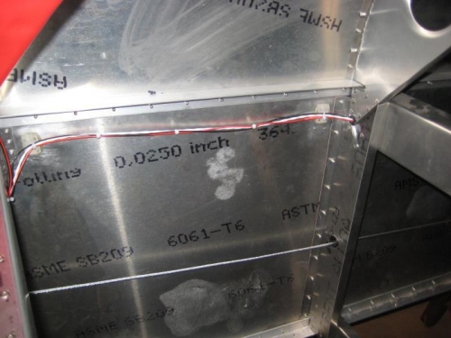

Wires passing to the right of the passenger seat. Again, zip ties and Click Bond supports.
