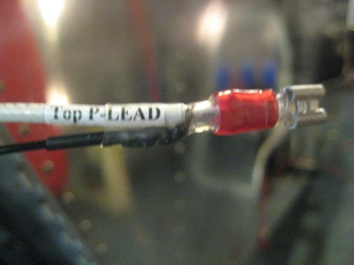

- Finished the engine-end of the P-leads. They are shielded, so I had to include wiring a ground wire to the braides shield, and then adding a connector to the end of those ground wires. Connected the P-leads to the mags, and the ground wires to the firewall ground block.

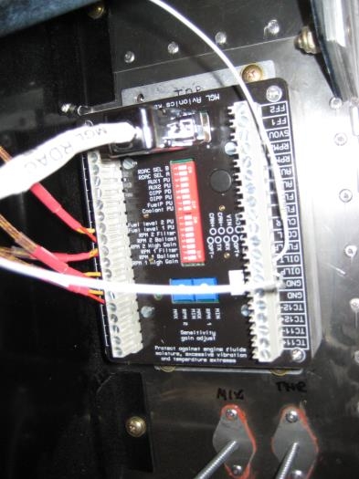

- Then began wiring the RDAC box. I connected the CHT leads, Oil Temperature and Oil Pressure wires. The EGT wires will go in after the engine exhaust is completed.
Finished the shielded P-lead wires.
Starting to wire up the RDAC
