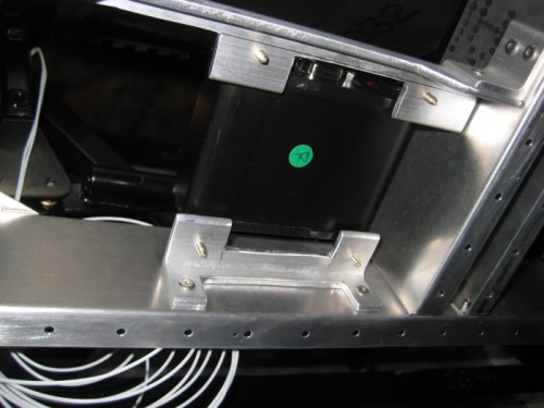

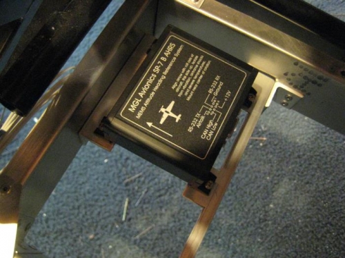

- Finished the second bracket for the AHARS, and riveted in place.
- Then began working on the bracket for the magnetometer. That had to get mounted in a location as far away from ferrous metals (steel/iron) as possible, so it went 2 bays behind the cockpit.
- Photos for the magnetometer are on the next page.
AHARS in place on brackets.
AHARS from below. Cuts in brackets are to save weight.
