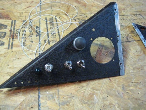

Began installing the switches in the instrument panel faces.
- Photo 1 has the green light to show the smoke is on, then the smoke toggle switch, the master switch, and the mags switch (inverted because mags ON = switch OPEN). Above that is the push to start button.

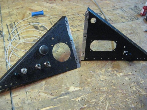

- Photo 2 shows the right side panle as well, with the cabin heat knob installed.

Left panel with smoke light, smoke switch, master, mags & starter.
Right side with cabin heat knob installed.
