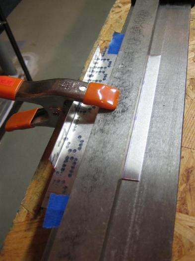

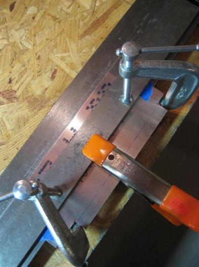

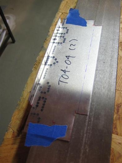

A part clamped in place.
I use tape to hold the part in alignment so I can put the brake parts together without moving things.
The solid bar of the brake goes on top, and the spring clamp holds it in alignment.
