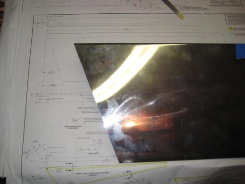

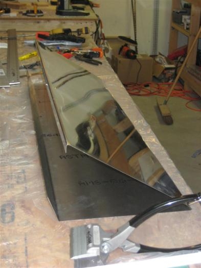

Bent then cut 2nd elevator skin
- Bent the 2nd elevator skin
- With the skin taped closed, I measured and cut the angled inside edges of the skin.
- I took the tape off to open the skin, then with snips I cut just outside the lines I drew on the metal, then finished with files & sandpaper

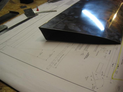

After bending the 2nd elevator skin
Then cut the inside edge of the elevator skin per the plans
I cut just outside the lines on the metal, with snips, then finished with files & sandpaper
