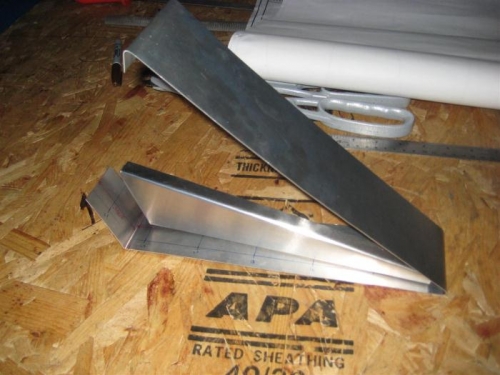

- Cut out the rectangular sheets for the 2 elevator skins, and filed the edges.
- Used some scrap alum to test the bending procedure for the skins. It worked very well, actually. I need to polish the skins before doing any bending.
- Spent the rest of the time setting up to use the router on the final 3 wing ribs: 1 nose rib and 2 wing ribs.
Test piece of metal for the control surface skin bending
