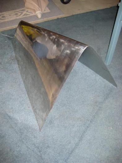

Bent both of the horizontal stabilizer skins using the same method of "squishing" the leading edge as I did with the vertical stab.

"Squishing" the leading edge of the skin
What it looks like after squishing
