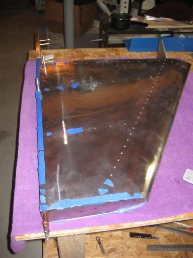

Date:  3-29-2010
Number of Hours:  1.50
Brief Description:  Rivets on 2nd side of vert stab
- Updrilled all the holes in the flip side of the vert stab.
- Installed all the rivets I could.
The blue tape is to remind me NOT to rivet those holes. I still need to install the fiberglass tip, and the rudder hinge. I'm not drilling the holes for the hinge until I get the hing later this week, so I wanted to make sure I had enough loose skin to debur the holes when I do drill them along the trailing edge.
