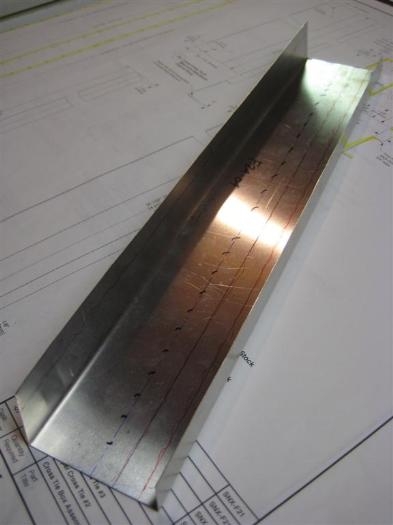

Finished F24-04.

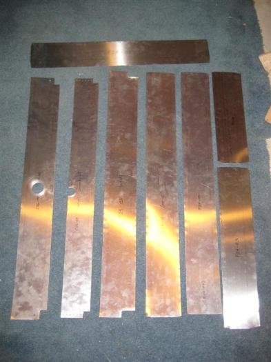

Laid out long channels:
- F24-02
- F24-03
- F24-05
- F24-10
- F24-11
- C06-04 (for low seat mod)
Also made the cuts for C06-05, but measured to the centerline of the notch, where it was supposed to be to the near edge. Oops! The seatbelt brackets go where the bad notch is, so I'll have to remake the part. I DID measure twice and cut once... I just measured twice to the wrong point.
Flat, waiting to become channels.
Damn! Mismeasured. They are both supposed to be centered. The bottom one is off 5/8
Damn! Mismeasured. They are both supposed to be centered. The bottom one is off 5/8".
F24-04. It just fit on my bending brake.
