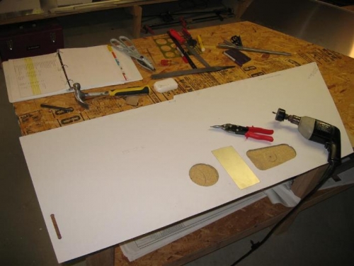

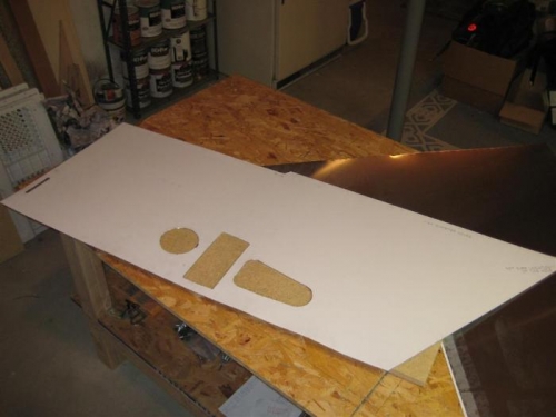

Continued working on F13-01 R, one of the forward fuselage pieces. Used some large hole saws in my hand drill to cut the round holes, and to cut holes in the rectangular sections so I could then get in with the red snips to cut out the straight lines.
Also bent one W17-02. The bend is a short little flange, so the lack of leverage makes it harder to bend. I have 15 more to bend!
Using hole saws to make the cutouts

All the cutouts made
