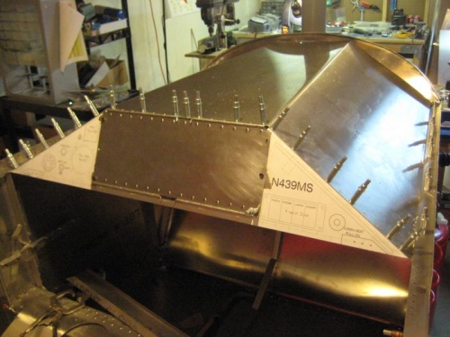

Glare shield & Instrument panel
- Installed one more floating nut plate on the instrument panel. I'm two-short, so used clecos for now, until I get more.
- Located and drilled to secure glare shield
- Made second hinge halves for the center (removeable) instrument panel, including removeable bent hing pins (like for seat pan).
- Located and pilot drilled all holes on the 3 top edges of the instrument panel.
In progress: locating and drilling for panel
All holes in the glare shield, inst panel & panel hinges
Closeup of hinges holding inst panel in place
