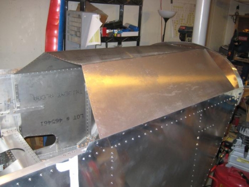

- Test fit the glare shield in place (photo #1).

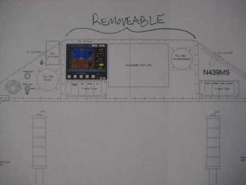

Started building my panel. I don't have any instruments yet, but I have the layout to scale. Per photo #2 I plan to make the two ends fixed (riveted) in place, and have the center section held in place top-and-bottom with hinges (like the seat and cowl), and the vertical edges with some nut plates and screws.

Glare shield test fit into place
Panel plan: two ends are fixed; center section is removeable
Look at photo #2, then this one, and you can recognize the removeable center panel
