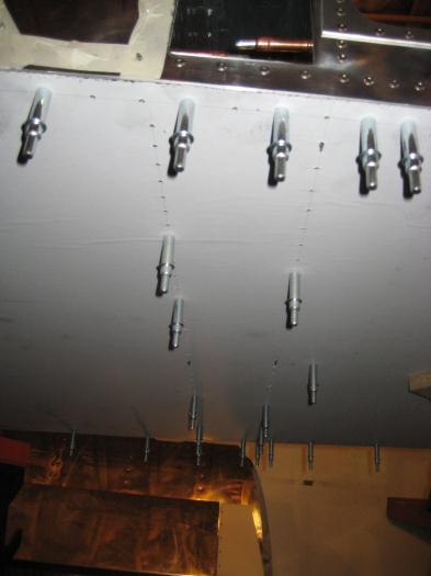

Misc pilot holes in forward fuselage
- Pilot drilled into the lower flanges of the spar tunnel webs (photo #1)
- Dimpled the side brackets at the top of the spar tunnel & fuselage intersections (photo #2)
- Counter sunk the 6 holes in the spar tunnel, where solid rivets are installed later.
- In the lower firewall, laid out and pilot drilled all the holes on the centerline for the stiffener.
- Drilled just over half the holes in the upper firewall where the upper and lower firewalls meet (photo #3).
Upper and lower firewalls meet
