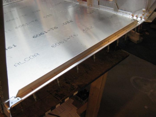

Brief Description:  Bottom skin + forward cross ties
- Drilled pilot holes in lower forward skin, from previous pilot holes inside the fuselage (photo #1).
- Installed lower cross tie with pilot holes and clecos (photo #2 and #3).
Although I've drilled holes and pilot drilled for the lower forward skin, I only drilled about 20% of the holes; just enough to hold everything in place and aligned. Next I need to drill all the rest of the holes, including the bolt and screw holes that hold the forward and aft fuselages together. Then I can go to the next step which is the firewall.
Added holes and clecos between forward and aft skins
Lower cross tie pilot drilled and cleco'd
Upper and lower cross ties in place
