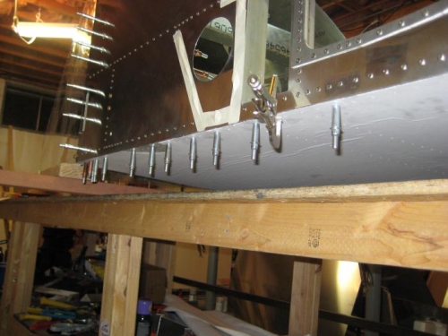

Brief Description:  Fwd fuselage side panels + bottom skin

- The I needed to install the forward fuselage bottom skin. Since I took the fuselage off the sawhorses and placed on the workbench I needed to elevate the fuselage so I could get to the underside. I did so by placing two 2x4's under the rear fuselage, and letting one side of the bottom skin overhang the workbench (photo #1).
- I clamped the front of the skin in alignment with the lower motor mount bracket per the plans (photo #2). Then I aligned on edge of the skin and began pilot drilling and cleco'ing (photo #1).

Aft fuselage elevated so forward fuselage bottom skin can be applied.
