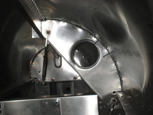

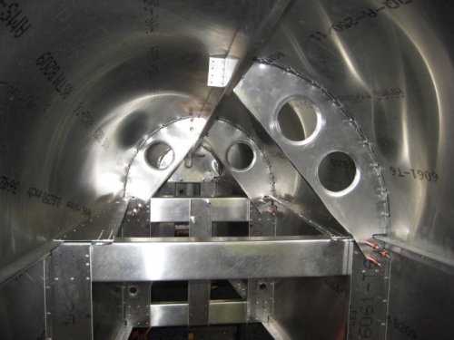

- Drew marker lines down the centers of the flanges of formers #3 and #4 to aid in centering the formers on the turtle deck holes.
- Installed (pilot drilled, updrilled and cleco'd) both #4 formers.
- Installed (pilot drilled, updrilled and cleco'd) the left #3 former.
I have the aft fuselage on 2 standard height sawhorses. It's a real pain in the knees and other joints to continually climb in and out from under and inside the fuselage from below (bottom skin is not in place). That's what slows down progress on these formers.
Former #4, right side.

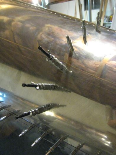

Wing-nut type long reach clecos to hold former tight to turtle deck.
Formers #5, #4, and the left #3 former.
