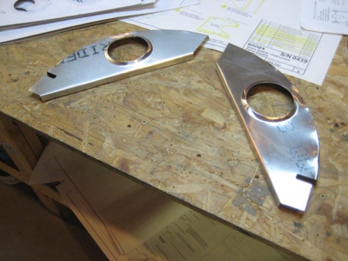

Worked on miscellaneous items tonight:
- Bent some of the fuselage pieces (photo #1). Unfortunately I bent one of them (F07-07 R) in the wrong direction (the one on the left), so I had to remake the piece (the one to its right). I got the bend in the LEFT piece correct.

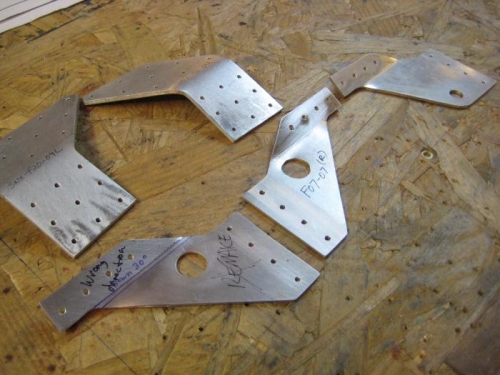

- I had previously made all the turtle deck formers, but has not bent the flanges. I received a set of former blocks (for bending the flanges) from someone early in my building process, but as it turns out NONE of them were made correctly, so I have none to use. Therefore I simply used the edge of my work table with a plastic hammer to bend the straight flanges, and used seaming pliers and regular pliers, along with my fluting pliers, to manually bend the curved turtle deck formers #4 (photo #2).
Bottom left is the
Bottom left is the "oops" piece.
Turtle deck formers #4.
