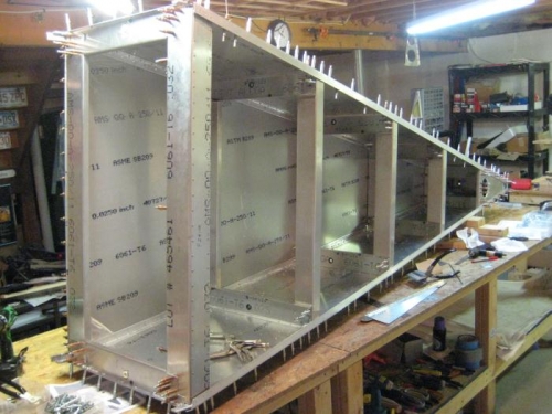

- Installed all 4 lower cross ties between the buldheads and against the lower skin (fuselage is on it's side in these photos). Clamped, pilot drilled and cleco'd them to the bottom skin, then pilot drilled all the holes joining the lower cross ties to the bulkheads (photo #3).

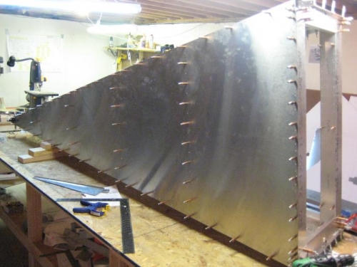

Bottom skin updrilled
Tailcone on its side. It was very easy to install the lower cross ties & bottom skin this way.

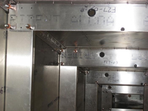

Lower cross ties at the left, located and updrilled.
