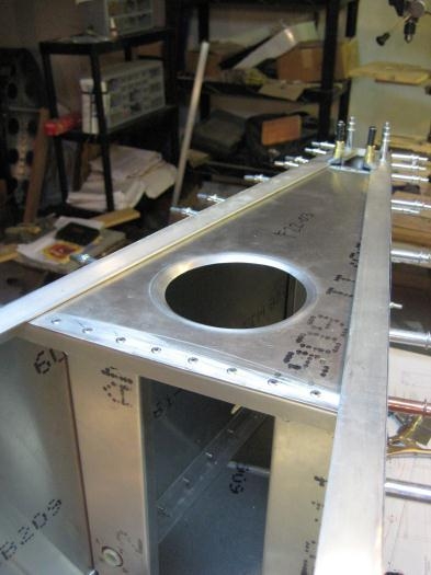

Some more photos...

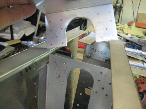

Shear web F22-03 clamped in place. Angle F22-06 is out of view underneath.
If you don't drill these in place, mark them with a sharpie while everything is assembled.
