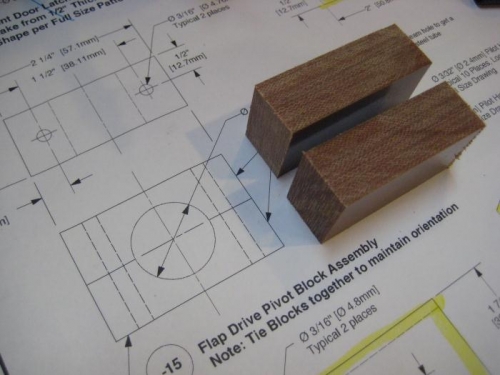

Made one of the two flap drive blocks:
- The stock comes 3/4" thick and a little over 1" wide. It took me some head scratching before I realized that unlike the other phenolic pieces, to make this one the SHINY faces go against one another (photo 1).

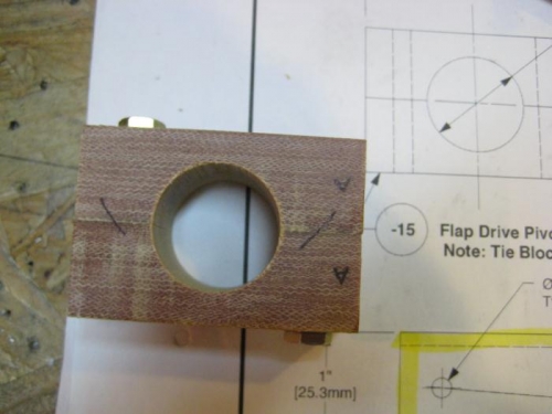

- To hold the blocks together while drilling the large 1" hole I put in 2 AN3-7 bolts; one in each hole but from opposite sides (photo 3).
- The resulting wide faces were not quite flush with one another so I put the assembly in the vice and used the vixen and then the mill files to get them flush and smooth.
- Put the assembly into the drill press vice and drilled the hole with the 1" forstner bit. I put some marks on the faces (photo 3) to make sure I matched up the right blocks in the right direction later.
The blocks are oriented with the shiny faces facing one another
Drill press vice and 1
Drill press vice and 1" forstner bit
Finished block
Finished block
