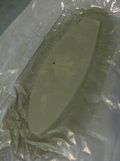

- Spent time driling one of the angle brackets at the aft most channel. This is to secure the bracket to the upper longerons.
- Deburred a number of the to-size holes at the forward end of the tailcone.
- Prime painted both of the fiberglass wing tips. Cleaned with mineral spirits, lightly sanded the whole thing, cleaned again with mineral spirits and then a clean shop cloth.
- Prime painted with a rattle can of primer; 3 or 4 light coats.
Prime painting the fiberglass wingtips.
