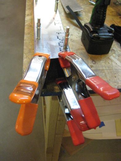

2 channels clamped to work bench at near end. Cap strip clamped on top.

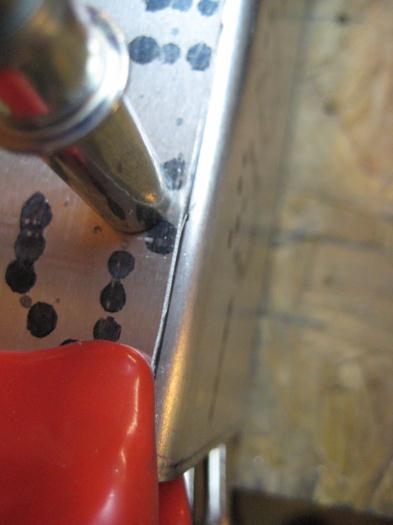

Align cap strip with offset line on channel. Pilot drill, cleco, measure 3
Align cap strip with offset line on channel. Pilot drill, cleco, measure 3" to the other face.
