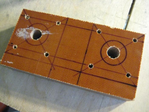

I started making 2 of the 4 fairleads (photo #1), made of 3/4" phenolic material. Drill bits go through it like butter, but the bits heat up FAST, so you have to back off and let them cool. I don't have anything quite big enough to drill the final 3/4" diameter, so I'll get some spade bits tomorrow. Then I can cut out the blocks and insert the guides.

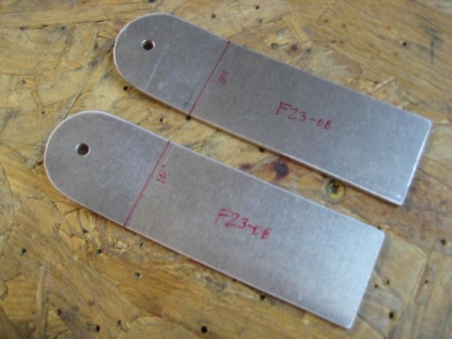

So I re-made the 2 seat belt attach brackets (photo #2). I had them made already, but a Sonex drawing revision called for them to be 1/2" longer to make attaching the seatbelts easier, so I decided to go ahead and remake them.

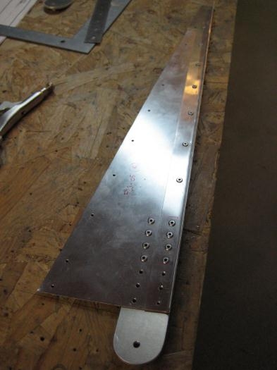

Drilling 2 of the fairlead blocks
.125 seat belt attach brackets
