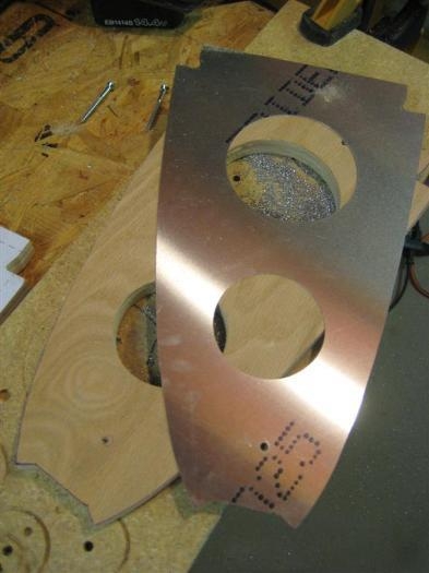

- Finished making the plywood blocks/patterns for the flush router bit to follow
- Used them to cut out two wing nose ribs. The router method really works slick. Quite a mess of aluminum shavings, though.
I have a video up on YouTube, of the process for cutting ribs with a router:
http://www.youtube.com/watch?v=kpZyJPbEons
Router with flush bit, about to cut lightening holes
Top and bottom blocks with aluminum sandwiched between
The finished product. A little deburring and it's ready for flanging & bending
