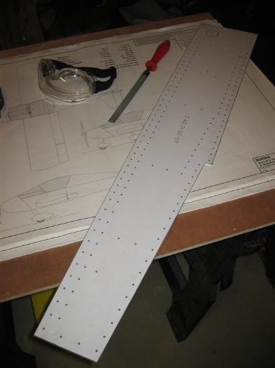

- Cut out patterns & glued them to the aluminum.

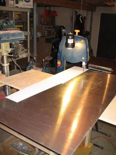

- Cut out W10-05 (1 of 2) on the band saw. Filed the edges to a finished edge. Set all the pilot holes. Began to cut the large hole at the root end, but was too noisy to do late night.
W10-05 on the band saw
You can see the paper pattern stuck on with a glue stick.

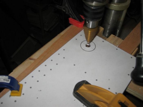

Drilling the large hole at the root end.
