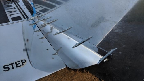

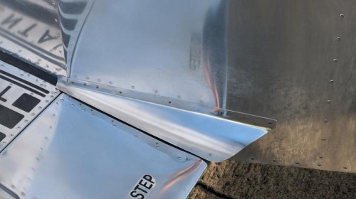

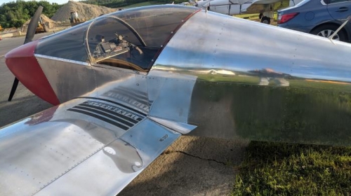

Wing Root Fairings
Time: about 1.5 hours.
In testing I couldn't really tell if there was a measurable difference in performance, but from my earlier tuft-testing the fairings definitely smoothed out the air flow, and there was no negative effect.
Tuft Testing:
https://www.youtube.com/watch?v=-FxvUdQCZTg&t=54s
In process
In place on the left side
From a distance
