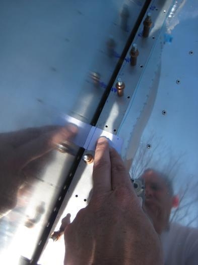

1. Cleco'd the wing root doublers (that I have previously marked and cut) in place and remeasured. I used a piece of the rubber gap seal to check the size of the gap I needed. After confirming, I marked a piece of paper with the gap dimension and put it against the fuselage (photos below). I then marked the doublers all the way around the wing.
(So tonight I connected the dots, and cut along the new lines, to give me the final dimension so I can rivet the doublers in place.)

Measuring and marking the gap
Same, but looking from further back
