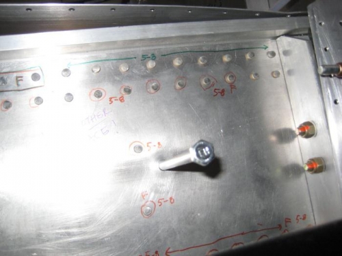

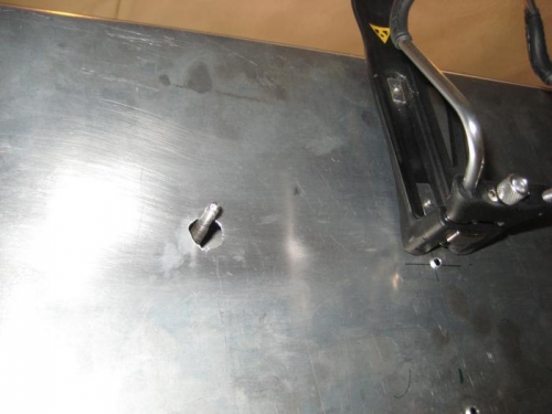

- Put the 3 alignment pins thru the wing spars (photos #1 & #2). I had to enlarge the spar tunnel holes a bit to get the pins through.

Alignment pin from rear of spar
Same pin from the front of the spar tunnel
