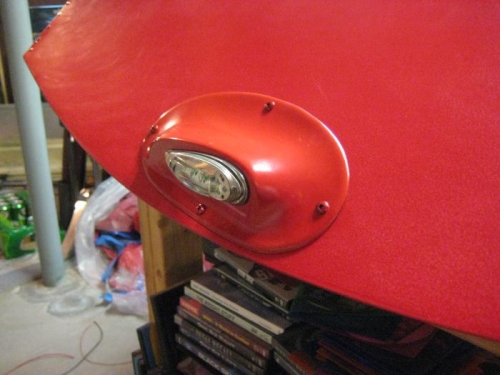

Left Wing - install tip & light
- Took the masking tape off the left wing tip
- Cleco'd the fiberglass wing tip in place
- Connected the position light to the wing wiring with solder and shrink tubing
- Riveted the wingtip in place
- Attached the wing tip light
- Used red automobile touch up paint to paint new (silver) rivet heads
