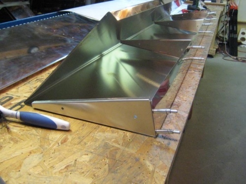

LEFT flap construction
- Laid out the angled cuts at the inboard/root end of the flap skin
- Made the cuts at the angles with the Dremel cut-off wheel
- Made the rest of the cuts with the shears

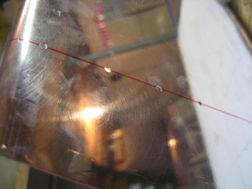

- Laid out and drilled all the pilot holes in the skin, for the rib attachment
- Marked all the rib flanges with a centerline
- Drilled and cleco'd one face of all the ribs (photos 1 & 2)

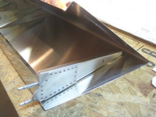

Outboard end
Inboard end
Typical pilot holes in skin
