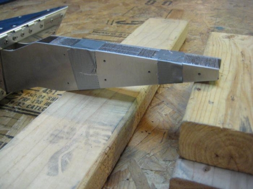

- To hold the lead in place I proped up the aluminum counterballance arms with wood, and duct taped the lead in place
- I then drilled through the lead and out the other aluminum leg. Sounds easy, right?

To hold the lead in place I proped up with wood, & duct taped in place
