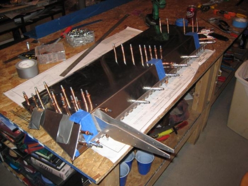

LEFT aileron construction
- Got the last rib located and pilot drilled, then updrilled all the holes.

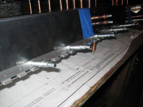

- Pre-drilled small pilot holes in the hinge, set the hinge as I did for the right aileron, then
- Started drilling the hinge into the aileron. Got a half dozen holes set.
