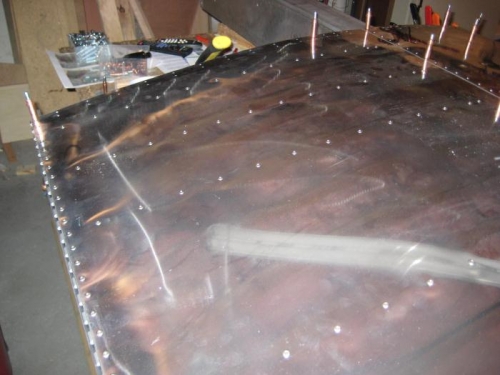

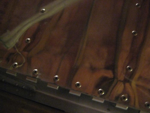

Brief Description:  LEFT wing riveting!
FINALLY! Riveting!
- Cleco'd the rest of the skins in place
- Got almost all of the lower aft wing skin riveted in place
Things to make sure you check before you pull that first rivet:
1. That the leading edge skin is lapped ON TOP of the aft skins
2. That you mark the root doubler holes so you DON'T rivet them. That step comes during wing rigging.
3. That the hinge halves are cleco'd in place, and in the correct location.
